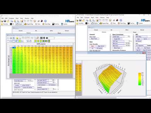

Here's the vid I watched. I heard him mention "better gas mileage" and I was hooked, haha. Plus, I like the fact that this timing table is for part-throttle only, which is where 99.999% of my driving is. I don't beat on my truck at all.
One thing I noticed RIGHT AWAY is more pep at take-off. The truck really liked that extra timing at part-throttle. I'm almost tempted to try a little more, but I won't do that until I have some way of measuring the results. I guess I could data-log and see if the knock sensors are activated, but I'm not savvy enough yet to start pushing the boundaries.
