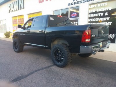

So I have a 2011 1500 with a 6" lift I have been researching a lot about a death wabel after installing a level can I get some input on this I don't want to level it out if I am going to have problems. Also would I run into any other problems it has a super lift on it.

Look into bilstein 5100 adjustables. Many use them safely to level 6" lifts.

You can't get death wobble in a Ram 1500 as it has IFS with rack and pinion steering. Death wobble is on solid axle vehicles (Ram 2500/3500's). As stated above, you won't have any issues leveling it out with Bilstein 5100's.
