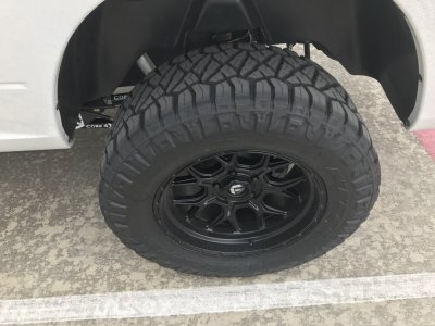

Maybe it’s the angle or flares, here’s a pic a little more straight on from couple weeks ago, click it and zoom in. But honestly I’m not sure how it was stock.
If your going 37’s get the 5” coils, of your only going 35’s get the 3” coils
Here’s a stock pic

It's kind of a balancing act between keeping the wheel centered in the well, and still having tire clearance as the suspension moves.
The link suspension on these trucks cause the rear tire to move in an arc when the suspension moves. when the suspension compresses, the tire moves up and back in the wheel well. when the suspension droops, the tire moves down and forward.
In theory, if you have a large enough lift, larger tire, and keep the wheel perfectly centered at ride height; it would be possible for the tire to contact the rear of the fender when you load the bed, hook up a trailer, or flex the suspension off road.

Ya I added the procomp rear drop brackets, I wanted the control arms parallel. It’s not a requirement, I wanted a different setup and plus I just can’t leave anything alone lol
https://www.ramforum.com/threads/rear-suspension-upgrade.125522/
https://www.ramforum.com/threads/the-custom-rear-control-arm-thread.124839/page-2
I recently switched from 37’s to 325’s and my current fender height is 45-1/2 at all 4 corners.
https://www.ramforum.com/threads/new-fuel-wheels-and-tires-installed.139402/
When I initially had it lifted it was 46-1/4 all around and settled over time to about 46 to 45-3/4
