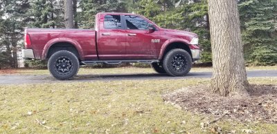

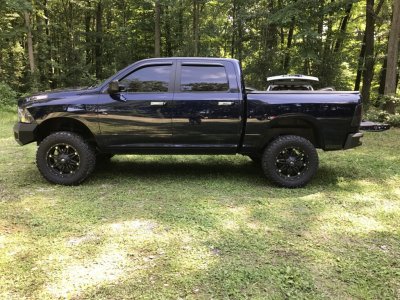

Zone 6” lift with 5” coils with eibach pro lift set to 3.5 in the front 1 full inch nose high
I’m running zone UCA’s as well

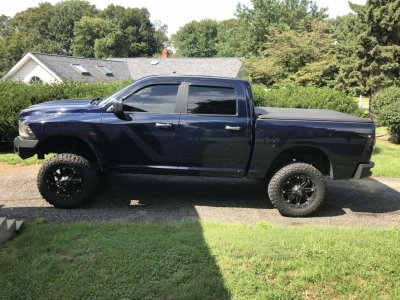

This is a zone 6” kit at stock ride height with 5” rear coil and 35” tires

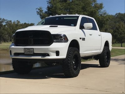

Zone 6in with 5in coils and bils at 2.1 but also left out zone preload spacer

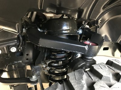

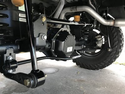

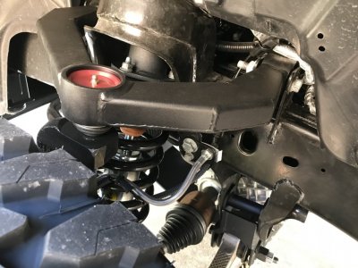

I have the 6” BDS lift with 5” rear coils and Bilstein 6112 set to 2.6” front lift and Zone UCA. I added the UCA to bevon the safe side and just do everything at once. If you add Bilsteins or eibachs you discard the preload spacer. Since you mentioned Superlift, If you look at their 6” installation instructions you’ll see they have 2 options, one uses a preload spacer, the other uses Bilsteins w/o the preload, not both. The preload spacer is merely used so you don’t have a huge strut top spacer. Zone uses a 5” top spacer so without the preload just add your Bilstein or eibach height to that number to calculate your front lift height.
Here’s a few pics of my kit and suspension
