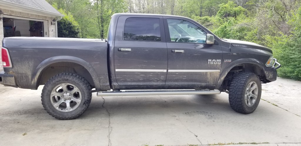

BDS 6/3 Fox 2.5 coilovers on the front, 295/65/20 on stocks. I've got some heavy bumpers and a winch on the front. Sits level.20200406_170948.jpg
