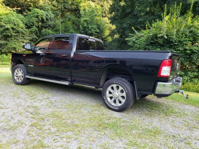

I always get the 8' bed. I am a custom furniture maker so when I go on lumber runs I can easily carry 16' lumber with the tailgate down. I like having the extra room in the bed for whatever I need the truck for.
Red

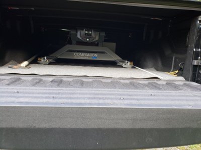

i have the 8' bed on my 2500 SRW ... my trk has the puck 5th whl system with a B&W Companion hitch ... i figure the difference is about 20" between the 6'4" and 8' so because i leave the hitch in all the time i just about break even and the hitch weight helps smooth out the ride
