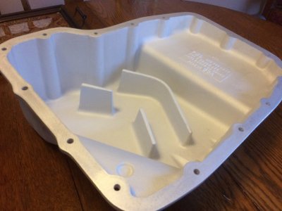

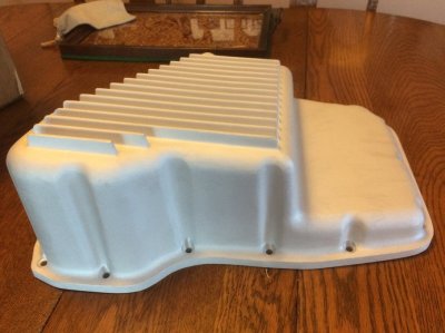

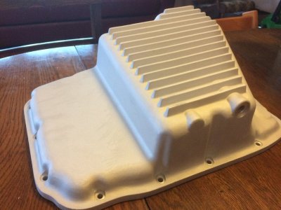

as promised.
this is the PML 11079 ( deep pan with step) for my 66RFE. supposed to be around 2+ quarts over stock i think. the "fins" on the inside are all about 2.625" tall and the ones on the outside are about .4375" tall. The pan comes with a magnetic drain plug, allen head bolts and washers, catalog, instructions AND A STICKER!! i love stickers...:Pshyco:
EDIT: this is the "cast finish".. no paint. $245. going with a white paint with a hardener from work. its getting painted this week sometime. I wanted white so i could see any drips easier. it will be a gloss finish. not the best color choice but functional.

Nice looks like a great pan! Definitely want to see painted pics and install pics!
How heavy is it? I was surprised at how heavy the MH pan is....

Very nice indeed. It looks massive and the internal fins appear to be anti slosh baffles. Would that be correct?

Yes, I think that is the purpose of the internal fins

I would guess it is a good 20lbs.
