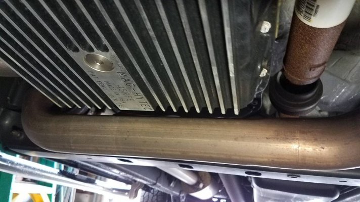

@jettajam1, here's some pics I took of my crossover pipe while I was changing my oil this morning. Looks like mine is flat on top which is great for clearance but not great for flow. Might have to look into a custom y pipe assembly in the future.

Hmm , I guess I just haven't noticed the flat top on my pipe ? Gonna have to take a closer look

Yep, for sure. I was actually counting on the flat section helping me with clearance during my install attempt. I think I measured around 4.5 inches from the top of the Y-pipe flat (I was at a weird angle when I measured, so it could be a bit more), to the bottom of the trans. So I'm almost certain the MH pan will clear when installed.
Also the flat section is perfect for collecting residual fluid and saving it to burn off at a later time[emoji15]. Lesson here is, make sure you thoroughly clean it off prior to running up to temp.

Because the exhaust is so close to the transmission pan, i've wondered if using that adhesive heat shield (the expensive stuff) on that pan in the little step were the exhaust goes around, would help with dropping temperatures a little bit.
Technically it can't hurt but I wonder how much it would help. It just bothers me a little bit knowing how close it is to the transmission pan makes you wonder how much the exhaust contributes to the temperature.

Going down the highway it's probably not bad but in stop and go traffic it has heat up the transmission...
