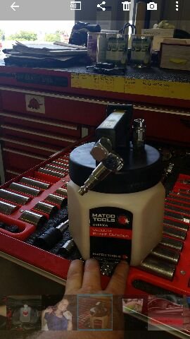

You can reduce the messiness of the pan drop If you have a small diameter tube with a vacume pump , something like this .
You can suck the pan out through the dip stick tube , this keeps you from dumping fluid while dropping the pan ....can't believe oem pans don't have drain plugs
