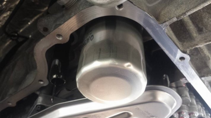

I think it's especially important because we do not put the filter extensions on these transmissions with the deeper pans
Kind of hard to see and it's completely at the wrong angle, but here's a pic of the dipstick tube next to the spin on filter. If memory serves, I believe it stuck down slightly lower than the spin on filter but not as low as the intake tube on the screen filter. Unfortunately I didn't take any pics of that.

That would be even better because then it would be guaranteed that the filter is sucking up fluid.

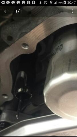

Yep , I think Hemi's picture ( I zoomed in ) shows the dip stick level or ever slightly above the spin on filter WHICH does ensure anything on the dip stick means your sump filter is definitely submerged in fluid !....ab42b7a019be0c40b23dd6b11712f84a.jpg
