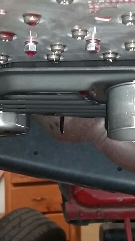

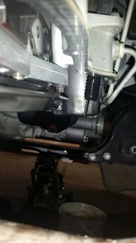

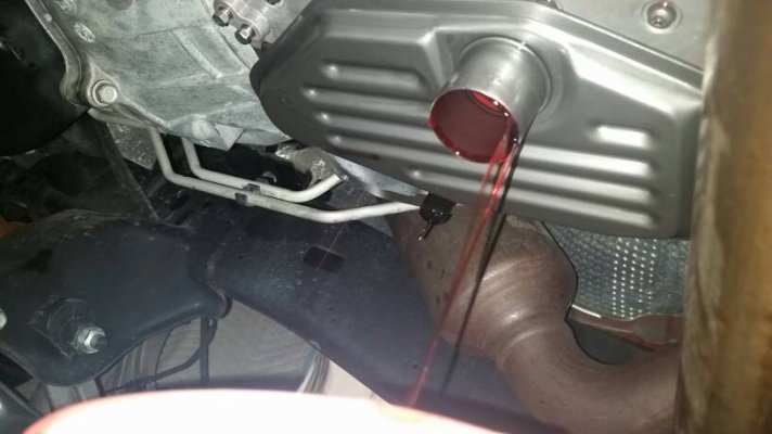

R.L.K.
R.L.K.
Dec 1, 2013
12,803
12,508
Bristol , Tn.
That would be even better because then it would be guaranteed that the filter is sucking up fluid.
Yes Sir , well above the sump filters intake tube !1a44ca5b8ece804a5f46b30db2b9537b.jpgfd47b2a754467d6f4a63b018a3283090.jpg3ab2f77d5220a71c8973d5d0d57933bf.jpg
Sent from my SM-G900V using Tapatalk

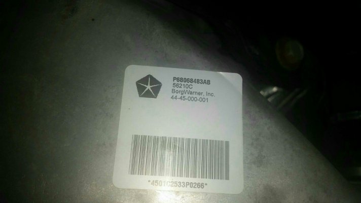

R.L.K.
R.L.K.
Dec 1, 2013
12,803
12,508
Bristol , Tn.
Nice write-up @R.L.K.!!! I need to get one of those t handle Allen heads. Starting those bolts with an Allen socket while holding that heavy MH pan was NOT fun...
I have the 44-45 Borg Warner Xsfer case . Didn't you service yours with the Redline C+ ?d31b9d664f8469de0e34ffad43cc67f8.jpgeb90b57cd7e92f94da41baf127489397.jpg
