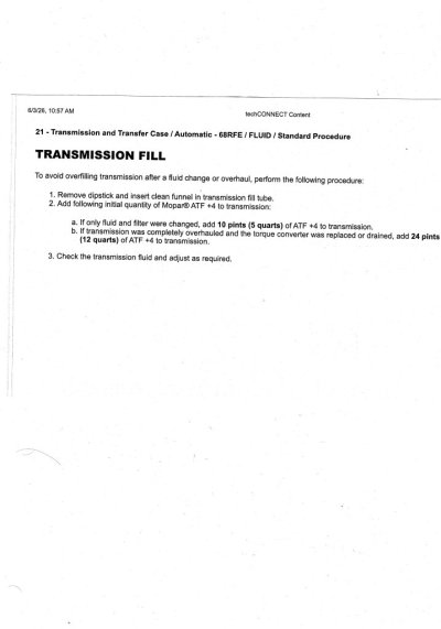

With the old fluid still in the trans.....I wanted to drop the fluid level in the pan so I can then drop the pan without a full pan of fluid. Easier to manage. Then I would replace the two filters, fasten the pan back, and overfill the Trans with new fluid as you said and following your procedure. What do you think?
