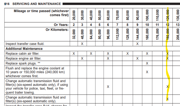

where do you see this at. All the info i find, its 60k / 4yr. nothing about 120k miles. I would never let it go that far. Not without some testing the mid term. i test my engine oil. and would do the same if possible on the trans.
The owners manual... I agree I would not go 120K either, I did mine at ~70k but doing it at 30k seemed a bit much but I wasn't tracking you were at 4 years with that low of miles. I put almost 25k on mine in a year Lol
I think that the time mileage you list is either for server usage like heavy towing, police, fleet or for the RFE 66 six speed trans used with the Hemi and not the RFE68 six speed trans... My 2022 RFE68 six speed trans has a service interval of 96 month or 120K for normal usage but for server usage it drops down to 48 month or 60K...
66RFE for my 2014 6.4 Hemi Ram the manual states 120K or 12 years. Luckily (or not... LOL) my tranny has never made it close to that long before blowing up and needing to be rebuilt (presumably with fresh fluid). Rebuilds were at 38K and 90K and I'm now at 120K.

ok, so i found it in the manual 120k miles. Not sure If i should go that long. Yes Ram will stand behind it IF its under warranty. at 5yr old, its well out side the window. So IM guessing all these blown trannies are not from fluid issues? Just hard part failures.
