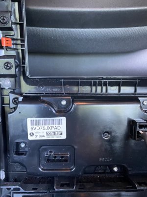

At this point if everything still works correctly with the originally 5.0 radio/HVAC controls & resistor... Then it's the harness or possibly the 8.4 HVAC control bezel.
What's the date code sticker on the back, b right of the bezel?

The only indication I'm seeing on the back of the bezel is this one below..

No sticker towards the right side?

Negative, nothing else on the bezel besides that. Yeah, I guess that will be the next thing to do! On shift tomorrow so will have to wait until Thursday, I'll let you guys know how it goes. Thanks again!
