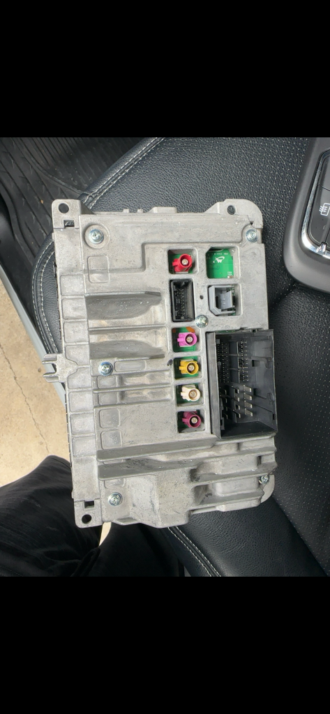

i just swapped in a nee 2018 ram radio that has nav and dual climate i have a manyal climate control and everytime i click the ac button i hear the ac kick on but it just blows heater air all the buttons work but it just wokt turn on the cold air, also whem i turn the fan into the 7th it just turns completely off i need help
hvac module and harness are from infotainment

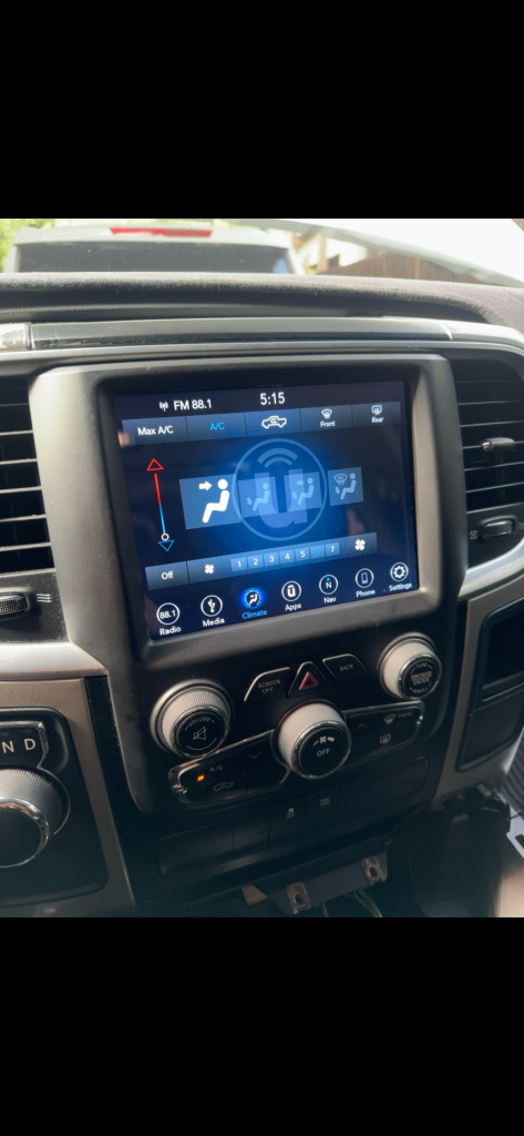

today like 1hour ago but yes i see what you mean the radio went from dual to single zone now but the air is still hot

yes hvac buttons respond and light up also clicking the ac on the buttom and radio makes the compressor click on but no cold air

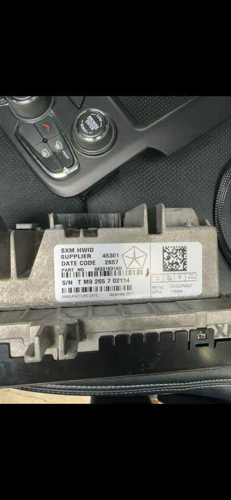

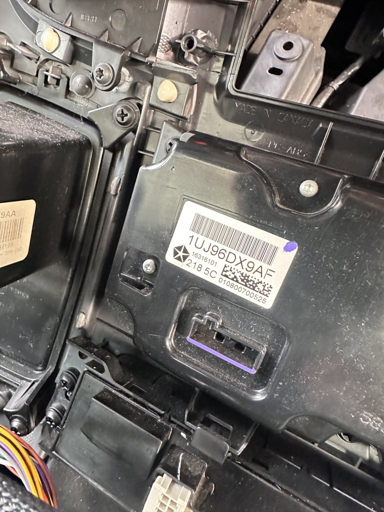

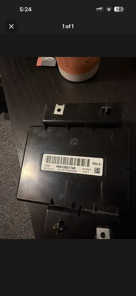

yes i originally had the 3.0 with manual controls and 7speed fan, i got the radio from ebay and harness with the hvac module also from ebay, but the guy claimed to have bought it from Infotainment i got the part numbers

Unfortunately this scenario keeps happening to people.
If you have a 2017 ram 1500, and with the items you bought from eBay ... You don't have the correct items you need to do the upgrade correctly and will need to replace some things to do it right. The only things you can likely keep will be the radio, 8.4 bezel, and USB setup.
More info will be needed.
I'll sent you a private message with info I need if you'd like to get correct items for this?
