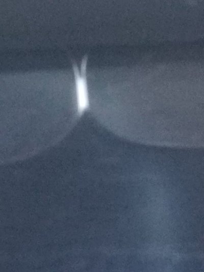

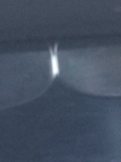

I have this same problem on a 2018 I bought in June certified pre owned. Started about first of July with bubbles in each corner, then slowly spread across the top of the screen till the two bubbles meet. Took it to the dealer today and he insists where the bubbles meet is a crack. Says he has to look into it and see what Chrysler and my extended warranty says. I think I'm about to get screwed.

View attachment 469098View attachment 469099View attachment 469100View attachment 469101
Like said above.....it should be covered..
My 2018 was changed out....dealership said it was a known problem...
I'm 100% positive its not a crack...if he needs proof tell him to push on it.

I agree that doesn't look like a a crack. It's where the two delaminating bubbles are coming together. A couple hot days and it might just connect.
