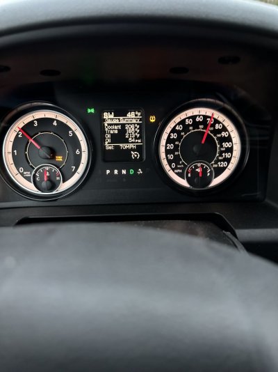

I have noticed warmer temps from the trans in comparison. Classic with the 8 speed approaches the high 190's unloaded in stock form. Not towing. My 2500 with the old 6 speed towing Jeep on a uhaul stays under 170. Think the 8 speeds runs a little warmer.
