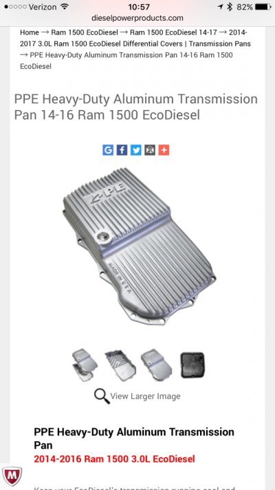

If this pan is deeper than the OEM plastic one, there may be a clearance issue with the stock exhaust crossover on Hemi trucks. If it's deeper, the pan should work fine on Hemi trucks with long tubes, or with the stock exhaust crossover relocated with some custom welding and pipe work and an aftermarket y-pipe.
If the pan is the same depth as the OEM plastic pan, it should work fine on Hemi 8-speed trucks.

I agree, but if you could re route that exhaust, which I think should be done anyways, this would be a good way to save money in the long run.
I don't believe in lifetime fluids. LoL

If someone could post a pic of the stock pan/exhaust clearance this might help determine if this pan will fit a Hemi or pentastar equipped truck. I would take the pic but I have the 6 speed...

With 2 extra quarts of ATF, suspect it's deeper than the OEM pan, which would make it iffy to install with the stock exhaust crossover.

Hemi395
Mar 18, 2013
9,505
17,671
Cape Cod MA
Looking at pictures of this pan on PPE's site it looks like theres a step built into the pan for clearance of the exhaust crossover pipe. I don't think there will be a problem with clearance...
