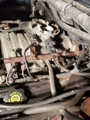

Hello DodgeTX,
I have attached a manometer and am not getting any pressure, or very little, actually. I even pushed the check valve of the fitting on the fuel rack and almost no pressure is seen there with the ignition switch on. If, however, I cycle the ignition switch several times, I'll get a small spurt of gas out of that Schrader fitting when depressing with a fingernail. I suppose if my fuel pump was working correctly, I should have fuel shooting out that fitting. It's quite rusted along with the rest of the fuel rail. I'm including a picture of it.20191025_201719.jpg

6.7 diesel
Just checked the fuel pump relay and it is fine. I also got a little more fuel up to the engine but no where near 45 PSI. This might mean a bad fuel pump which entails dropping the tank I presume. By the way, I have not found an in-line fuel filter so am I correct in assuming the filter is also in the tank and part of the fuel pump?
