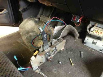

Anyways I got the ratchet shifter installed yesterday.
Also had the truck running again and found out my passenger side fuel rail has a hairline crack and is leaking :( so I ordered a new set of Arrington billet fuel rails today. Also ordered a new alternator since this one is toast.

Thanks guys and I'm really liking the looks of the shifter to. It definitely made my life easier when hooking up to the tranny.
I'm actually going to look and see if I can find a pistol grip style handle to try and make work and replace the cheap looking ball knob with. My cousin was the one that gave me that idea lol

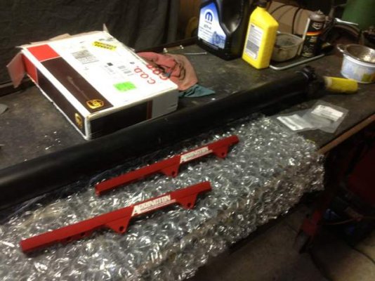

Well got my new driveshaft back and installed on Thursday. New billet fuel rails also showed up but they forgot to send the crossover kit to join them together!! The missing parts will be here tomorrow.
So since I've been stuck waiting on parts I decided to spend some time giving the truck a much needed bath!
Fingers crossed on a test drive tomorrow night.
