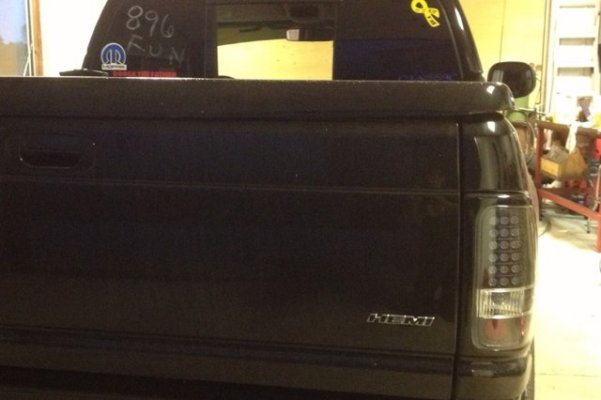

Finally got around to adding this nice little touch I picked up on my trip last weekend. I like it since its nice and subtle and most people won't even notice it there
