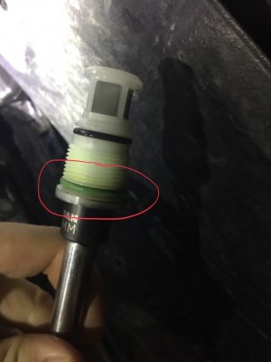

Can we get a pic of that rubber o ring trick? A pic of the fitting etc? Thanks

Tach-tech you are a champion. Thank you sir! Excellent pics!
