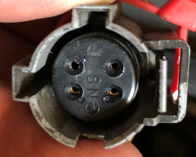

I have a 2008 Dodge RAM 1500 with a 3.7L V6 and I recently replaced a bad A/C Discharge Line.
It had a pin hole in it from rubbing the alternator.
I have everything hooked back up and I pulled a vacuum on the system then added a 12oz can of refrigerant.
I noticed the compressor clutch never engages and I’m trying to figure out why.
The only fuse I see is a 20 Amp HVAC fuse which it tests good.
I’m wondering how to bypass the pressure switch to see if the issue is the compressor clutch or the pressure switch or something else.
The pressure switch connector is a 4 pin connector but only has three wires that connect to it.
I’m tempted to use a paper clip to jump the wires together but I’ afraid if I pick the wrong two wires I may fry something.
Though I would play it safe and ask you guys about it first
Any Ideas?

I already have the manuals and it does not say how to bypass the pressure switch and the connector in the wiring diagrams does not match mine. Thanks anyway though.

How can I bench test the clutch with it still in the truck?

Should be easy. Using a VOM (volt/ohm/meter) … test for a positive lead (wire/contact) inside the plug…. and also for a “ground” leads.
The positive lead is seeking a “ground”…. so simply use a jumper to “ground” the positive lead to the engine block or frame. That should engage the compressor clutch.
Do not use the “ground” leads found in the harness, as one of them is likely a “sense” line and any positive current applied “may” cause errors.
After ypu have partially charged the system with refrigerant, the connector might be re-connected and the re-charging can be completed.
(Disclaimer: The above method is what was used when installing after-market compressors in early Toyotas.)

Thanks Grams for explaining a safe way to determine the use of each pin. I will try this today and let yall know.

Keep in mind….this is a diagnostic excersize to determine the connector-logic……you are only using the connector and VOM to decipher the compressor logic. It is the Compressor you are trying to energize! (I.E. don’t blow a fuse grounding a hot lead not connected to anything.)
