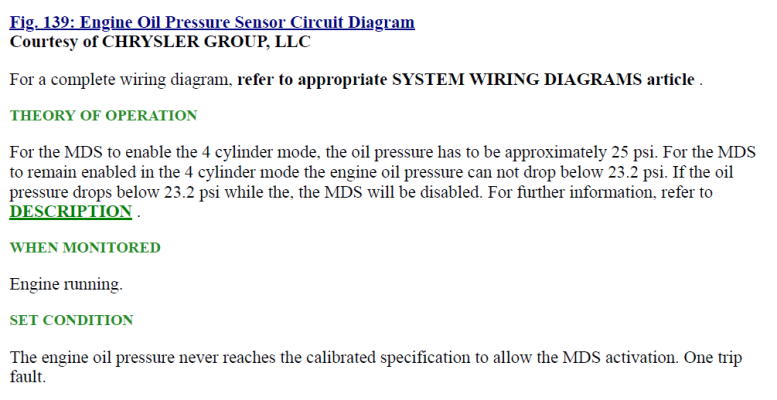

The threshold for problems is 25psi. The code description for p0524
Basically, per the "set condition", to set p0524, the engine spent a drive cycle and never reached the "MDS calibrated spec" which per the first sentence of "Theory of operation" is 25psi.
Not good.
Not good.
Nope, just what I told him. Meant P1524, sorry.
