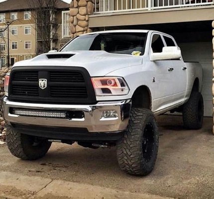

The man just asked for info and I gave him mine I've actually done the 3.5 but here's my Cummings and my wife's 1500 with the 3.5 spacer in front and everything else on these trucks I've done myself 5b57cc1ed2238ba18c8dc98a2499987a.jpgb0bfca22e3e033fee3c4ce05162be53e.jpg

All the proof that is needed to not take this guys advice.

i have a hard time believing that 1500 is aligned within spec with a 3.5" spacer. id also love to see some pics of the cv shafts and ball joints/upper control arms.
sometimes a little common sense goes a long way when buying things, like the simple fact that theres no reputable company that makes a 3.5" leveling spacer for a 1500, only ******** companies on ebay. i wonder why? im sure that extra inch of height is totally worth it though.
For the record...i never stated it couldnt be installed. its just stupid to install it on your truck.
