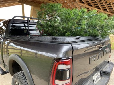

I've been thinking about getting one of these....How do you like it? Any cons or issues?
This is the 2nd truck I had a diamond back on, and it has not let me down. I got the HD model both times. I put weather stripping on my tailgate last month to keep the dust out and now it is pretty sealed up. I haul on top of it all the time.
