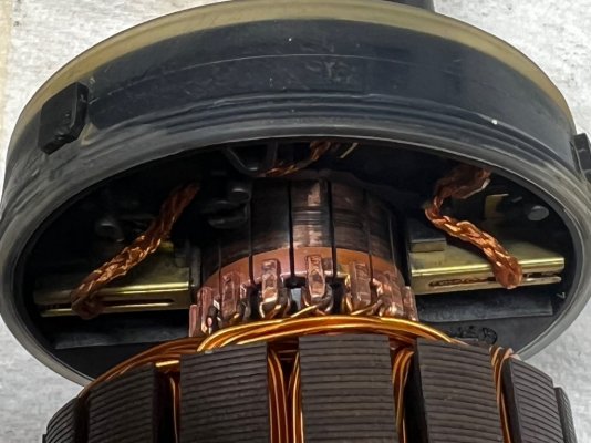

I did. The old unit felt loose the connection from the module to the HCU. Inside the hcu the copper wires have a “brush” on each side. Looks like a very small spring. One side was pinched and wouldnt let the part stay center. Going over bumps it would hit the wall of the until causing a short I think. Hard to explain but it was very loose. Poor quality is my guess. New part feels different

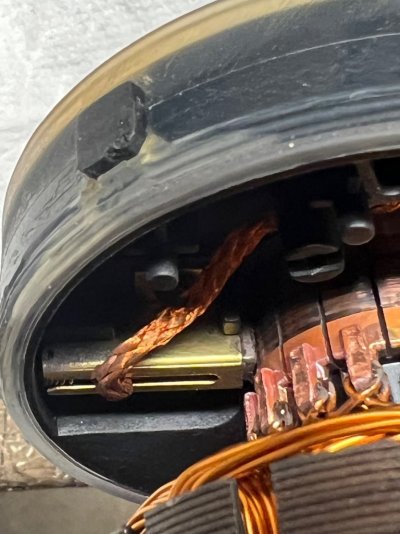

This part here was easily moving back and forth. On the new HCU this doesn't move.
Brush is bound up somehow. Almost smashed in place unable to move freely.
This side is normal. Springs back into place.

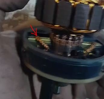

Minha RAM2500 2018 6.7 Diesel começou a mostrar a luz do ABS e do controle de tração intermitentemente há mais de um mês, o problema era o mesmo, a escova do motor do ABS estava presa

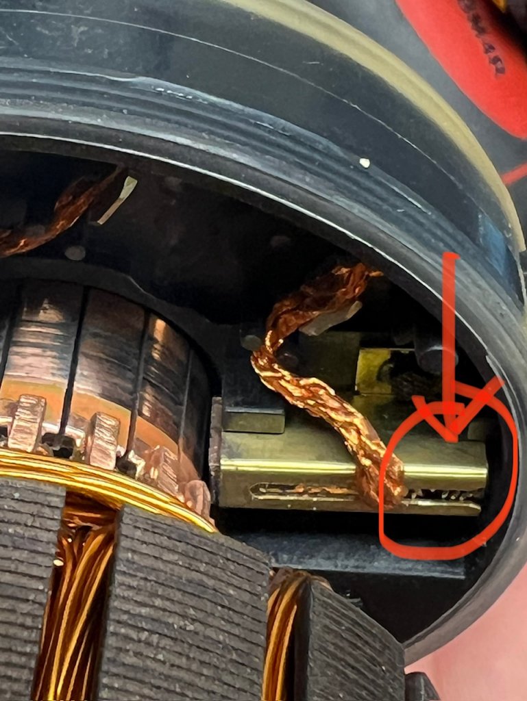

There is a spring in behind the brush that should keep the brush against the commutator. Looks like it is wonky in your pic.
EdGs
Nov 29, 2020
5,614
11,901
FL
I know. I took the pic and noted the problem. A lot of these failures are due to a faulty spring
Crazy that they get all jacked around like that.
Any possibility of replacing the spring?
Doesn't seem like the brush is worn abnormally. Would be cool if it was fixable.
