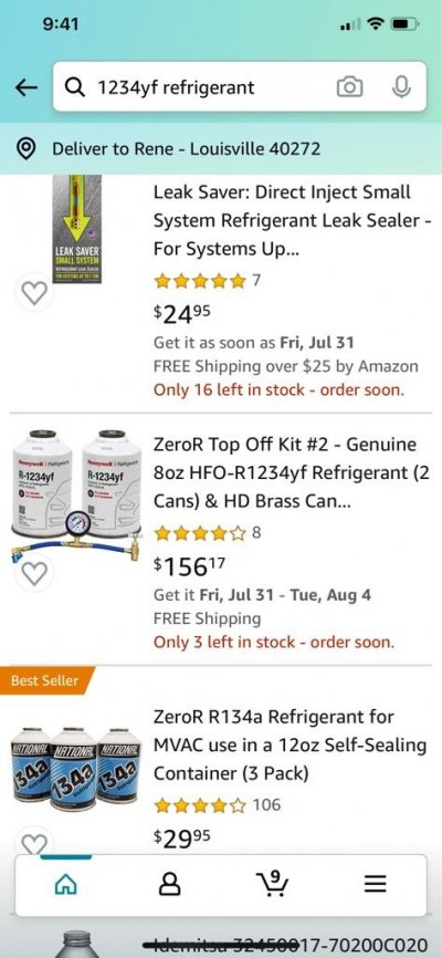

Anonymous007
Jun 26, 2020
269
208
KY
Either way, is not that important. You seem to be a diy person, should be glad this is available

Anonymous007
Jun 26, 2020
269
208
KY
I'm a professional mechanic.... 44+ years.
Even better. Should be glad to have access to it. I wouldnt want them to control freon for my car
