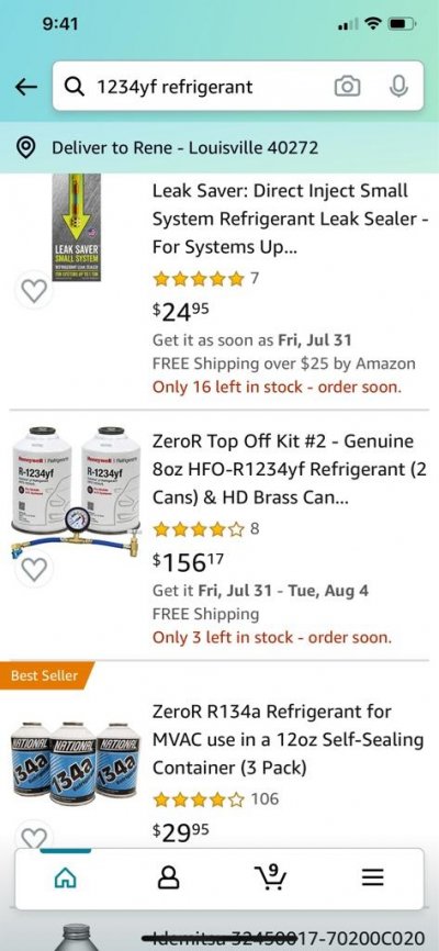

Nobody said you were wrong. You said it was illegal and needed a license to buy it and i showed you how you can easily buy it from amazon. Could it be illegal and need a license in the future? Maybe, possibly yes. As of right now any ody can buy 1234yf

You said it was illegal and needed a license to buy it and i showed you how you can easily buy it from amazon. Could it be illegal and need a license in the future? Maybe, possibly yes. As of right now anybody can buy 1234yf

You can actually buy it without a license, its fairly expensive but nothing crazy
$156 for two cans and a $3 hose? That’s pretty expensive. Especially when you compare that to the next item down, the 134a.
