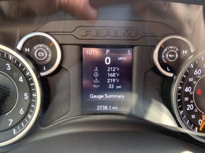

Anyone experiencing less than ice cold a/c with the active shudders? I’ve seen that they’re open at idle and in PARK but have to take your word for it at 35+ mph. I’m going to take it to the dealer to see about the cool air conditioning if I can’t figure it out on my own.

Never mind... I found it to not be an issue. I started it up in the driveway with the air on and it got down to 57 out of the vent. At 101* outside that’s not too shabby.
No comments about my thermometer...lol. My infrared thermometer was acting up.

57 degrees is too warm if you ask me. I have a thermometer coming soon, so I have no numbers yet, but I'm guessing my Audi air duct temps are at least 10 degrees colder than my Laramie. I haven't experienced the seasonal hot temps for my area yet with this truck, but even with the temps in the low 80's it takes more than 15 minutes of highway driving before my truck cools down to a comfortable temperature. When I drive my Audi it takes less than 5 minutes. Both vehicles have the same 20% tint (same shop even). I've read a few threads in other forums where people identified a problem with the blend door inside the heater box not fully closing. So they tried pinching off one of the heater hoses, and their vent temps dropped into the low 40's. I'm not willing to potentially damage a heater hose I'll need for half the year, but I'm looking into a heater hose valve I can open and close with a cable.
