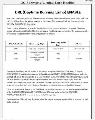

I'm assuming you have the projector headlights with the LED turn signals.... if so yo can turn them on as DRL's. Check out this thread about doing it yourself or you can also try and get the dealership to activate them.
DIY: https://www.ramforum.com/threads/alfaobd.123982/
or Dealership:

Oh the mirror turn signals, I thought he was talking about the led turn signal in the projector headlights!!!
