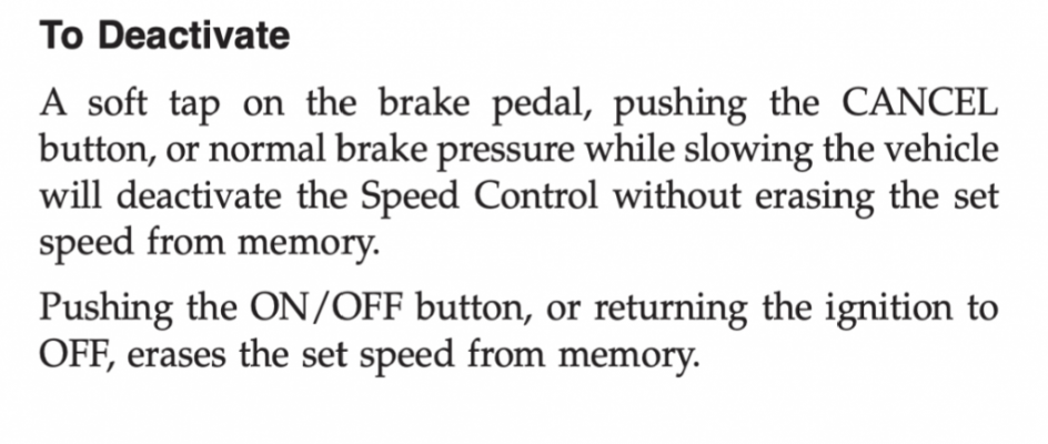

GTyankee
Nov 2, 2020
12,391
17,459
El Cajon Calif. 92021
3.0 ecodiesel
as it reads above, any time the brakes are applied, the cruise is disabled, but the cruise is still ready to be reset
