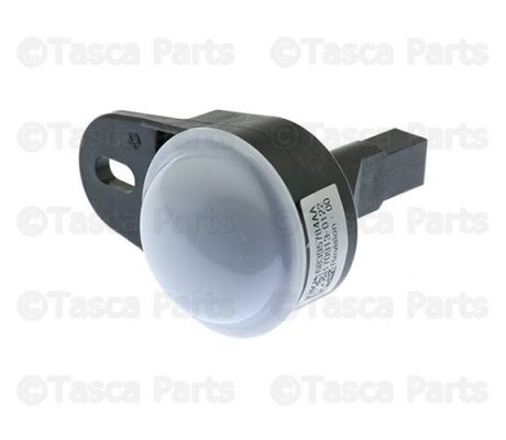

I'm wanting to add rear footwell lights to my 2017 and use the same housing as the front because you can run any 194 bulb in them. Anyone know where I can find the plug/connectors and pins to wire in two more just like the front? Dealer was no help. I found this part number but I can't seem to find anything to confirm it is the wiring and plug I need to add the older style 194 bulb housing. I will post a picture of the plug I'm looking for and the housing I'm currently using for my front footwell lights. 5102407AA8ecc2d10964696c821ac685a5c4ab7f0.jpg39496037b0915276d91613e98ecff249.jpg

I did it a lot cheaper by cutting off the stock plugs, and splicing on generic 194 sockets I got from Auto Zone. Plugged in a few Sylvania ultrabrite 194 bulbs. The driver's side I zip tied into place, the passenger side I made a hole in the top covering just big enough for the socket to poke through and twist into place. They're much brighter than the stock RAM ones FYI.
