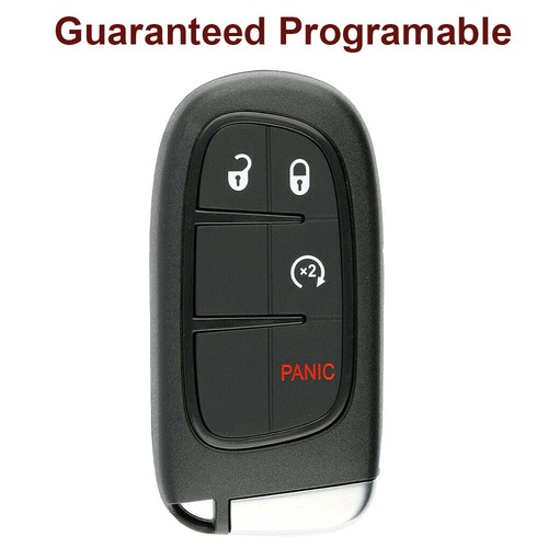

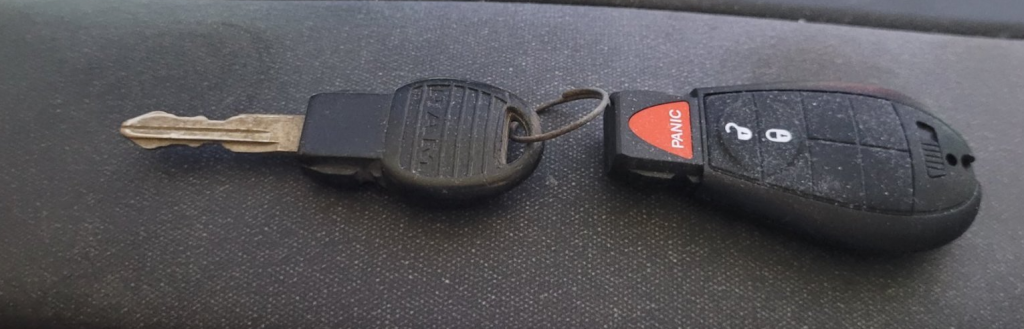

That is correct. I couldn't for the life of me figure out why I live in 2022 and truck didn't have remote keyfob/ lock and unlock.
Left is the key that I was supplied with.. right is the one I got from AMZ
All 4th gen has this feature built-in.. just need to activate it.

I have a friend , she has a plain 2011 with blade keys. I was thinking of adding Fobik for remote entry. I m glad I found this tread. Based on the success of this mod , I wonder if I just add a hood switch and enable remote start as well . Anyone try that ?
