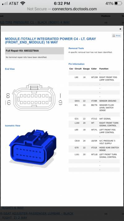

From my understanding there is no BCM on the earlier Rams. Your truck wiring would be coming out of the C4 connector under the TIPM. And I recently learned you may have a wire in position 3 on the connector but it may terminate about 6” down the wire harness. I would first confirm you actually have the hood latch connector. If you do, then you should have the wiring needed. If you don’t then you are missing wiring.

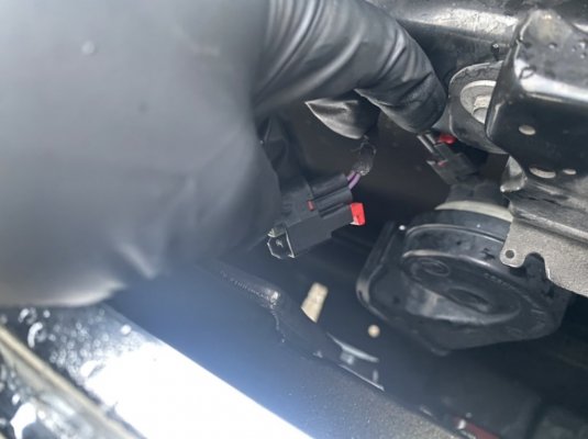

Ok @DoughRat19, so following up on this. Attached is a picture of the plug that’s dangling by the hood latch and horns. I assume that’s the plug for the hood latch sensor.
I also pulled the TIPM and snapped a few pictures of Connector “C”. I have a wire in Pin 3, there’s no wire in Pin 4.
Thoughts?

Well remote start works! Wohoo! I talked with John Lance and he was able to help me out. I showed him the pictures and he said all looked good and my truck is pre-wired.
I created a small bypass harness with a built-in 1k ohm resistor and used that to ground one of the pins on the hood latch plug (the one closer to the red safety lock). Then I was missing an important part of the process which was after enabling all the settings in AlfaOBD, you have to go take the car for a short drive. After that was done, the remote start began to work without issues.
I won't be keeping the bypass harness I made, it was just to troubleshoot. I'll be buying an OEM Hood Latch with the sensor integrated into it to keep it as OEM as possible.
I suggest anyone looking to having this done, to contact John Lance on the FB Groups. He sells an custom hood safety switch and everything you need for like $50. I just wanted to opt for the OEM option for my truck.

Thats not the right connector under the TIPM in your pictures, should look like this. Since you have the hood latch connector you should have all the wiring.
