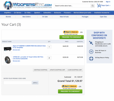

You have depth but there are not that many good 12" subs that will work in .75 cuft of airspace (assuming a pair and deducting for displacement).
If I had your box right now, I'd go this route:
Wire the subs for a final load of 4 Ohms (this makes the amp work less hard) and that Zapco will give them a hair under 1,000 watts.
