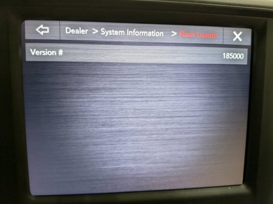

UAS is what you need. Can you post a picture of your "Application Version"?
I would gladly give you that info but I can't find it. Putting the radio in dealer mode seems to give me other random info but not the current software version.

@loveracing1988 That does look odd. I have UAV software, can you pull the radio and take a picture of the part number on the back?

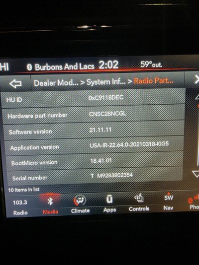

I have a 2019 1500 (DT) with the uConnect 8.4 4c with NAV. I'm trying to get my uConnect system updated and having issues.
My radio PN: CNSC27N3GL
App Ver: USA-IR-SBX-22.66.0-20220808-I0H1
Kudos to @Mpgrimm2 for the uconnect files!
I'd like to start using 39.6.
I went to "6. 2018-21c UAq Radio Update files" and grabbed 28.3, 39.6, and 40.1. I tried both the 28.3 and 40.1 and when I started the truck, entered into dealer mode (two finger presses on the bottom corners), then inserted the USB, I get the following error: "Cannot update Software. Software not compatible with vehicle."
I'm kind of at a loss here what the issue is or why it's not taking.

I think the problem may be that you need the 5th gen UAV files.

Confirmed, mines a "UAV" coded uConnect 8.4 4c NAV unit.
UAV update files worked tonight and they completed perfectly using the UAV version firmware!
Did two firmware updates from:
to
USA-SBX-8.4-MR-38.3.0-20190314-M0G3
to
USA-SBX-8.4-QR-40.1.0-20220821-Q0J0

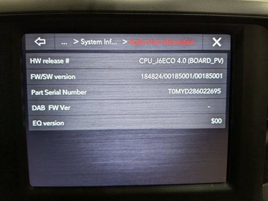

Hey wondering if you have firmware files for an 5th gen 8.4 with nav? Currently on JR-34.32 but trying to take incremental to 40.1
Yep, send me a PM with your gmail address.

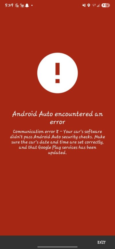

Curious if someone can help out, ive looked back into the thread and just want to get the most up to date info. I have a 2017 ram 2500 that came with the older 8.4" uconnect. So I bought a used 2019 8.4" UAQ. I keep getting a communications error when trying to use AA with my s25. I did add the newer harness and hub. Looked up the software and I have the 22.64. Wanting to see if i can obtain the newest software update as well as the newest maps updates. Any help would be appreciated. Attached are the current software and error message
I've had this issue, it's caused by a failed handshake between the phone and radio (possibly time is off). PM me and we'll get you updated. No maps update though, that's a paid item via UConnect and at the price they charge and age of the updates it's not worth it if you have Android Auto and CarPlay.
