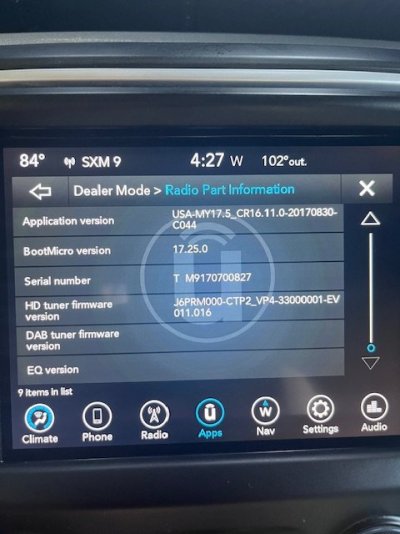

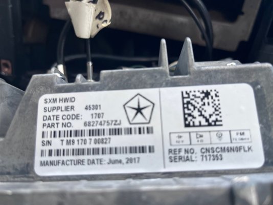

Anyone know what I should be trying to update this 8.4 to? got it for next to nothing and would like to set it up on my 2016 RAM 1500. Looks like it came out of a Chrysler has NAV and Sirius, CarPlay.

Looks like you have a VP4 unit and not a UAS/UAQ. I don't believe this unit would have CarPlay/Android Auto, but Sirius and Nav are likely.
Search the forums for VP4 firmware as a starting point or possibly even the Uconnect website.

It definitely has CarPlay because I see it and I am able to use it.
Weird, maybe there's something I don't know as I definitely am no expert on it. I would suggest starting here:
I've been reading but it like Greek at this point. Not even sure what radio I have anymore. Had SAT radio at first and now that has disappeared. Even though it shows a subscription.
Post # 3881 - Good Info on 4th Gen Ram Panasonic 4c Internal Hardware PNs vs Mopar PNs.
Your radio
Mopar PN: 68274757Ax
Panasonic 4c HW PN: CN-SC M 6 N 0FLK
Application version: 16.11.0
Looks like you have a very early 2017.5 Chry 300/Challenger/Charger,
4c UAq Nav radio with application version 16.11.0
Make sure you have a compatible/genuine 4c USB hub (See Post 5 )... Not a knock off. (Your original hub may not work for the updates, IDK)
Get the v18.14 UAq update from
the original fw thread, then go to v22.60. (keep truck running during updates, or on a charger... Low battery voltage will brick a radio... (Updates can take awhile).
Then you can go to v28.x, then to v40.x from this thread..
Keep in mind the risk with updates is completely yours.
