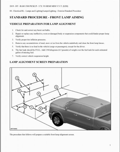

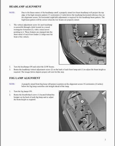

I don't have a pic but look above where the headlight sits. You'll see a hole you can put a Philips head through and adjust to your needs.
Adam vera
Jul 1, 2018
49
48
SC
This should help.
