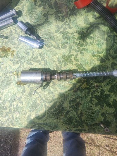

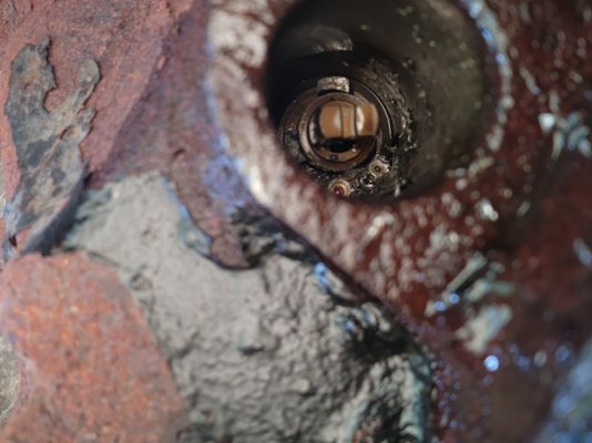

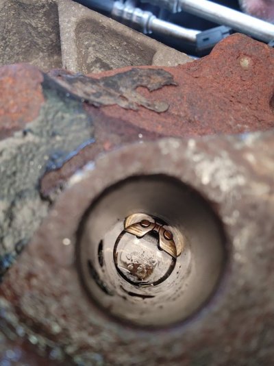

I did get around to changing that oil control solenoid. Haven't had a check engine DTC since and a big difference immediately I noticed.
Ran into a snag though and the old one was broke and was stuck in there. Had to use needle nose pliers to get the guts of the solenoid out and then I used a cement bolt to thread into it and pull it out with channel locks and a hammer.
