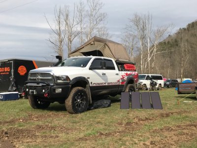

View attachment 126427 Hello all. I am a tech at a local dealer her in Indiana. We do a lot of these trucks and there is no need to buy these programmers anymore. This can all be set at your local dealer. My power wagon Tpms is set to 70 psi high and 30 psi low. So no light when I air down. But will still come on when tiresget to low on the road. I run 37 inch tires and 4.88 gears. All programmed by me at work lol for free.
More pics of your pw bro looks bad ass
