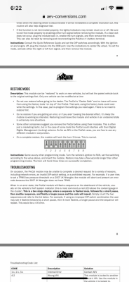

yeah I keep it plugged in...otherwise the stupid tire pressure light will not go away. Since I am keeping it attached, I pulled the OBDII port from the mount and zip tied it up behind the dash, otherwise my legs could hit the programmer. As for programmers I was going to sell my AEV Procal and then I noticed you are not able to unpair it from the vehicle...so I guess I am stuck with it even though it did not do what I wanted it for.

You should absolutely be able to unpair it. You could then sell it as well.

I thoughts once you programed your truck that unit was married to your truck? No divorce lol

Nope. It is married to it and cant be used on any other vehicle... until they get a divorce lol

Before I connected the tazer I did follow the instructions to return the truck to stock settings...the instrctions state their is no procedure to unpair the unit from the vehicle.

As for the AEV Procal - it's an expensive paper weight. :(

That’s what I was getting at earlier this week
Having the unit work on only one vehicle AT A TIME is completely understandable. Having it only work with one vehicle FOREVER is a bunch of ****. There is absolutely no need for that. Thats just greedy. Not sure if it is only for the brand new ones or what.
That was not an issue in the past.
