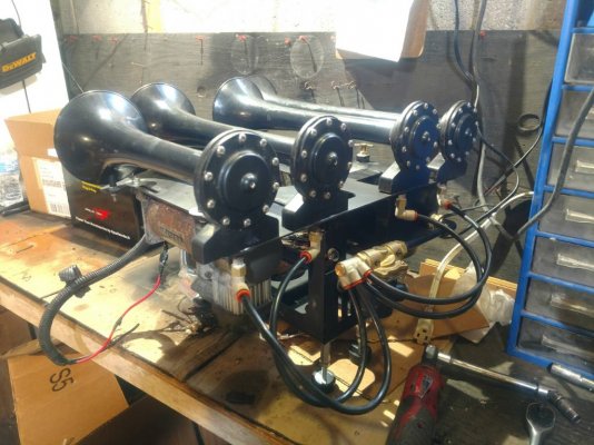

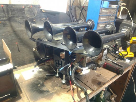

Ill definitely be posting some! its loud enough that you can feel it! lol Hornblasters says it can be heard from 4 miles away!!!!
It doesnt do it ANY justice but here is the same kit in my Raptor
Having an air compressor come on Every time I use the horn would annoy me
It's not that noticeable especially with the spare tire delete as the rubber pads help reduce vibration noise.
