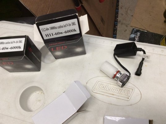

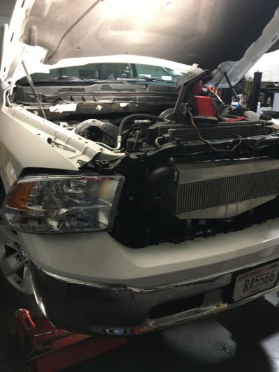

Installed led on my 19 classic and they were already high but de worse after a 4” lift I was get worried after 20 turns is anyone counting?7BFD4568-3F0D-4FB0-9A10-7183A5A1A75C.jpeg54762873-69F4-41B7-8F2E-4FA6847C23DA.jpegE58AAACF-8103-44C6-B6BF-94AE4AF7502C.jpeg
