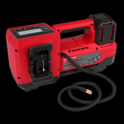

Milwaukee has a M12 tire inflator, but recently came out with a M18 inflator, (2848-20) that looks pretty good. If your into the Milwaukee tool platform, this would be a pretty good choice.

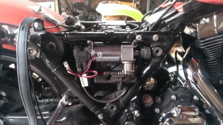

I have a small viair compressor mounted on my Harley for the air ride suspension and it's been working great for five years. I have it wired directly to the battery for on the fly adjustments. My bike can handle it just fine so I wouldnt hesitate to wire it into the truck If i needed oneIMAG0117_zpsfvzp33q9.jpg
