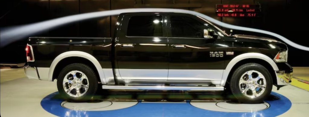

think more plumbing in existing hood scoop, but thanks for the wind tunnel comment, gonna tack a ribbon in the fender duct and toss a camera in to see what it does
