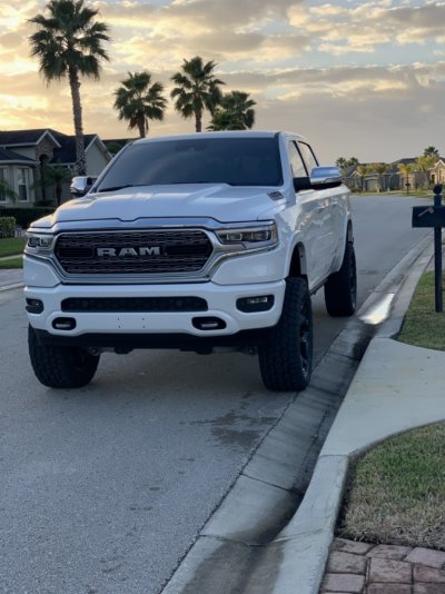

^^^. Seeing photos as above is the reason why I really want a lift kit. Yes I know I don’t ever go off road and some would call it a mall crawler, but I don’t care. For this generation of Ram I feel it needs a minimum of 4” to look correct. That and paired with no side steps lol.
I don’t care what anyone has to say. She’s a bad ***** now....
She certainly is. Did you maintain all 5 ride heights? Is this OR2? I would be interested to see pics of the different heights.

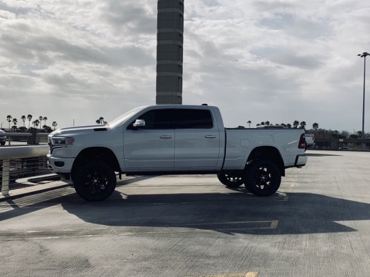

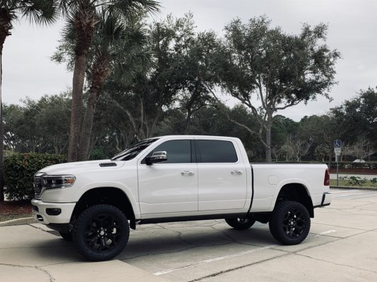

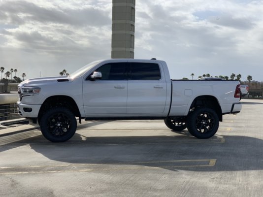

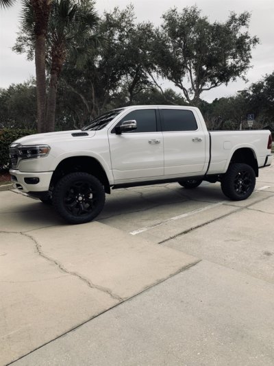

Yes it still allows adjustability on all heights. Still goes into aero mode on the highway, and all. I believe these pictures were at OR2.
While entering the airport parking lot, I had to drop it to entry/exit to even get it in there. I opened the moonroof screen to double check, and I was about 2-3 inches from hitting the roof, and they say it’s a 7 foot clearance.
If I drop it to entry/exit, you can’t turn the wheel very much to turn, it rubs on the inside.
