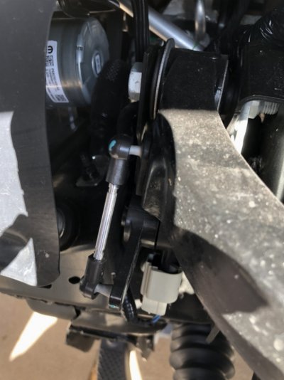

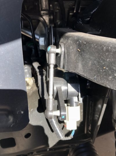

I went out and took some pictures of mine this morning and it looks slightly different. It looks like both the top and the bottom just pop off and there is no nut or bolt to unfasten. Looking for anyone who has some more mechanical experience or who has tried it to weigh in here. Or any other options out there.
Mine (2019 2WD Limited)

They just pop off. Take a bit of a tug. Do the end on the sensor last because they pop off easier at a bigger angle and you don't want to damage the sensor arm. It's just plastic. The replacement links are threaded and you lengthen the rears to raise the back and shorten the front to make it higher.

Are there different ones specifically for the 2019’s than the ones I linked to above? I guess the part that looks different is that it doesn’t look like I can unscrew the ball part of the socket on either end.

The balls stay in place. The arms have socket ends. Oe ones are fixed length and aftermarket level links are threaded for adjustment. They are just a press fit ball and socket joint.

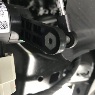

OP - thanks for this, I was taking pictures of mine yesterday LOL. I guess Ram doesn't want anyone removing the ball socket studs.

Here is a pic of the sensor arm showing the end of the ball socket stud. Maybe the stud does screw in to the arm. IMG_8887.jpg

Ok, I just saw in another thread that you used the Revel links. Those appear to be different than the ones from CFT as the Revel ones use the original ball studs.
