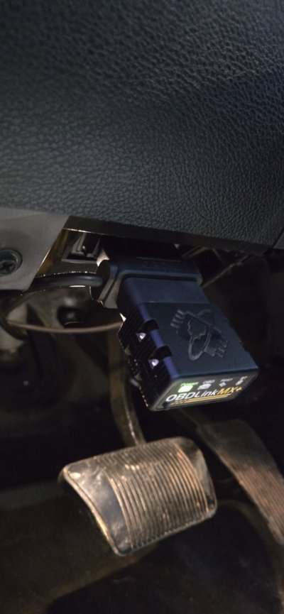

It's basically the one that is the pass through type that plugs into the OBD. I've used this bypass cable to change a good bit of stuff on my 2018 2500
GeauxApe12B
GeauxApe12B
Mar 3, 2024
16
13
Georgia
6.7L Cummins
That bypass you have is only bypassing the CAN C bus (only plugs into one junction block).
The hvac module is on the CAN IHS bus, which is not being bypassed on your truck with that particular bypass.
