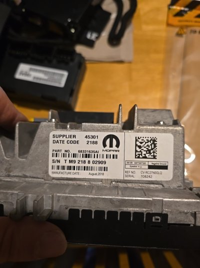

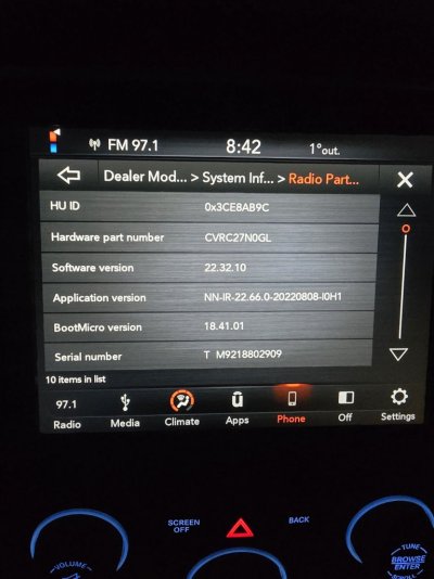

I am having trouble updating my radio I recently put in. I tried an update files already ive seen on this forum but I got a cannot update vehicle not compatibile error. My main issue is android auto doesn't seem to be working (I keep getting android auto error 8) I'm thinking it may be a simple update needed. Any help would be appreciated!

Looks like you have a UAS, non-NAV radio with 22.6 firmware. I have seen this error myself and it "might" point to a failing sierra wireless air card not keeping accurate time. You can update to firmware 40.1. PM me you're gmail if you'd like me to send you the files.
